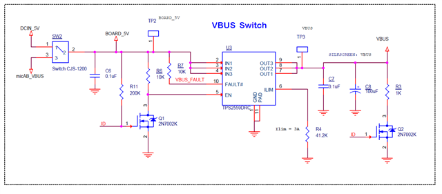

I’m reviewing the TUSB319 datasheet (page 10), and I noticed that the schematic places the required 150 µF bulk capacitor before the load switch (i.e., between VBUS and the load switch input), as required by the USB PD specification.
However, when looking at the TUSB319 evaluation board schematic, the bulk capacitor is placed after the load switch (i.e., at the output).
This raises a question: which placement is correct or recommended?
My concern is that placing the bulk capacitor after the load switch could result in a huge inrush current if someone mistakenly connects a USB Type-A to Type-C cable to this port. In such a case, VBUS would already be present on the cable (i.e., hot plug), unlike a USB-C to USB-C connection where power negotiation would occur first.
Has anyone else run into this or have a different perspective?

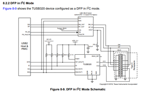

  • Hi Nir,
    We recommend placing the 150uF capacitor after the VBUS switch, like how it is on TUSB319EVM. We also have it like this on our new CC controllers. Here's the TUSB320, just as an example:
    I'll look at having this updated on this datasheet.
    As for your concern with placing it after the VBUS switch, this bulk capacitor for any DFP/DRP-DFP connection is part of the USB-C spec, so it is recommended to be implemented, and shouldn't cause any issues, as far as I am aware. We haven't seen any issues with it previously.

  • Hi Ryan,
    Regarding the inrush concern: I understand that the 150 µF capacitor is required by the USB-C specification and is expected for DFP or DRP-to-DFP roles. My concern is specifically about scenarios where a USB Type-A to Type-C cable is used—since the Type-A side provides VBUS immediately, this could potentially result in a large inrush current into the capacitor when it’s placed directly at the connector (i.e., after the load switch).
    Do TI’s designs account for this situation?
    Personally, I believe that placing the capacitor at the input of the load switch could help isolate it during hot-plug events, such as in the example above. Once the switch closes safely, the capacitor can still fulfill its role—even if it's located slightly farther from the connector's VBUS.
    Appreciate your help!
    Nir

  • Hi Nir,
    I did some digging on my own to see if we might have some scenarios where we have the 150uF cap before the VBUS switch, and we actually do have a few devices/CC Controller applications that place the bulk cap before the VBUS switch. One of those cases is with the HD3SS3220, which is our CC controller/Mux 2-in-1 device. Again, I'll see if I can get maybe a more technical reasoning, but going by that, I believe I can go ahead and say you should be able to place that bulk cap on the input into the load switch, rather than the output.
    Ryan
  • Hi Ryan,
    Thanks a lot for taking the time to investigate this and for confirming the capacitor placement — that’s very helpful.
    This topology is definitely preferred in our case. From a functional perspective, the physical placement of the 150 µF bulk capacitor doesn’t need to be right at the connector — it’s not as critical as a high-frequency decoupling cap in that regard. So placing it slightly further upstream doesn’t impact normal operation or compliance with the USB-C spec, but it greatly improves protection in scenarios where an external VBUS source might be connected.
    Thanks again for your help — really appreciate the support!
