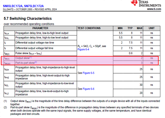

Hello team,
What would be output skew and part-to-part skew for SN75ALS172A? (Couldn't find them on datasheet)
Similar device (SN65LBC172A) has those specs on the datasheet.
