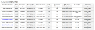

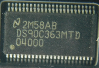

Can you please tell me if everything is in order with the labeling and marking (, in the datasheet labeling DS90C363MTDX >B (what are the symbols >B?), on the components DS90C363MTDX without >B, previously these components came with a different format of labeling
how to decipher the datacode and if it's there.

    The ">B" in the Packaging Information table indicates that the part marking on the chip "there may be an additional marking, which relates to the logo, the lot trace code information, or the environmental category of the part".
    According to the table, the difference between MTD and MTDX is the Package qty/Carrier.
    Could you share what the previous labelling was? And is there any specific reason you would need the batch info?
