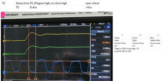

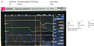

  • Hi Gerome,
    We do try to measure the RMII setup and hold time for TX.
    Tx RMII setup time is 8.4ns while the RxRMII hold time is 10.4ns
    Tx Hold Time
    Tx RMII setup time
    Wei Han
    Thank you for the TX measurements. This indicates that the requirements for MAC to PHY should be okay. What about the RX measurement?
