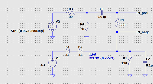

Hello team,
My customer would like to use this device with AC-coupled single-ended clock input.
Does this device accept AC-coupled single-ended clock input?

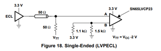

On the datasheet, there is an input configuration for DC-coupled single-ended.
How can customer configure for AC-coupled input? (Single-ended)
