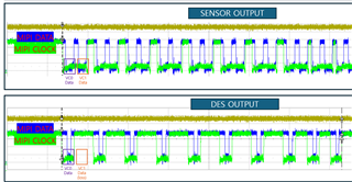

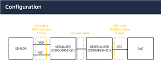

Here is our system configuration.
A single sensor outputs both VC0 and VC1 (MIPI virtual channels VC0 and VC1).
However, after passing through the SERDES, only the VC0 data reaches the SoC.
It seems that the serializer is filtering out VC1, and it may not support multiple virtual channels.
Could that be the case?
