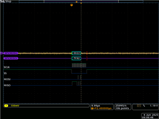

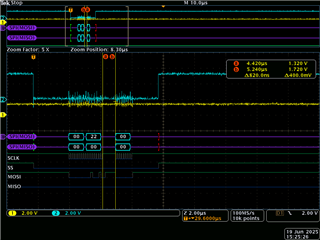

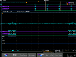

Dear team,
I have interfaced ADS131m04 with MCU with below hw connection, only thing is
1. CLKIN pin of ADS131 from Connector I have kept open, since i need it from local oscillator. Should i have to externally connect from JP6 to CLKIN?
2. SYNC/RESET & DRDY, i have connected it to GPIO & below is the GPIO config from MCU side
     For DRDY, GPIO configured as digital Input pin, pull up enabled, fast slew rate, passive filter disabled, Low drive strength & interrupt enabled on falling edge.
     For SYNC/RESET, GPIO configured as digital Output pin, pull up enabled, fast slew rate, passive filter disabled, Low drive strength.
3. SPI initialisation done.

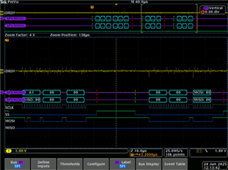

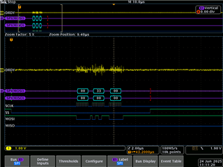

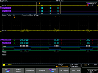

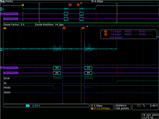

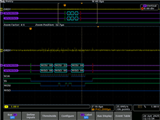

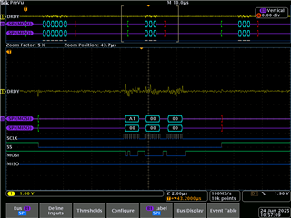

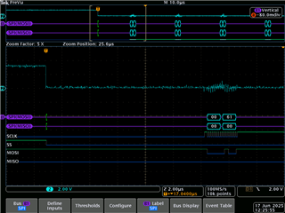

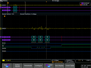

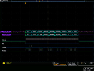

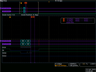

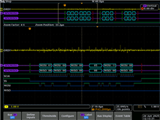

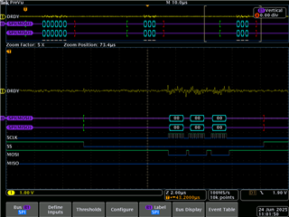

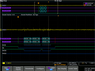

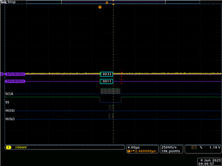

ADC initialization is not happening, also DRDY pin interrupt i get only once & the pin always remains low after that. Here if I monitor the DRDY pin on scope, at startup i get DRDY High(1.2V), after that only one inerrupt is raised & pin status goes from 1.2V to 1V & it remains stable at 1V & there is no interrupt observed on this pin later on.
On SPI lines, I can see some data on MOSI but not on MISO.
Anything i am missing here?
ADC startup, lib file i have attached below

    Can you send me a logic analyzer plot showing the communication signals from/to the ADC?
    BR,
    Dale

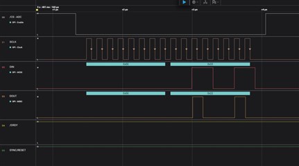

  • Hi Dale,
    I have attached the snapshots of Reset, standby & wakeup command. Response is not as expected & its varying on every trial.
    BR,
    SN
  • Hi SN,
    The response should be expected on the first word in next frame, not the same frame you are sending the command, see the correct timing as an example below:
    1st frame: sending STANDBY command (0x0022)
    2nd frame: see the M04 ADC's response (0x0022) on the first word
    -Dale

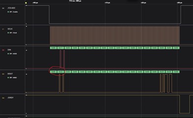

  • Hi Dale,
    I have tried to capture for longer period, but second frame response is not coming unless i send the command again.
    So, as per my observation I have to send RESET or any other command 2 times, in first command MISO is dummy data, during second command i get correct resposne.
    Is it correct? So i should send any command 2 times??
    BR,
    SN
    You do not need to send a command twice. Are you able to read any register from the ADC correctly?
    -Dale
  • Hi Dale,
    From ADSEVM, now i get correct response on next command.
    Now when i interface EVM with MCU, i am facing challenge in initialising. Below is my code flow:
    1. Clock INit
    2. GPIO Init
    3. SPI init-  8Mhz,16bits per fame
    4. ADC Init--ADC library i have taken from link : https://github.com/TexasInstruments/precision-adc-examples/tree/main/devices/ads131m08
    During adcstartup, there is no response i see from device on MISO line
    Below snippet shows Write single reg - Mode_Address & mode default val -
    dataTx={0x61, 0x0,0x0,0x05, 0x11, 0x0}
    Light blue - CS
    Is there anything i am missing?
    BR
    SN
    You are sending commands in 16-bit format as shown in your timing, 24-bit should be used for the commands as the word length, you can see the timing I shared with you in the previous post. Also, use /CS signal as the start and end of the frame.
    -Dale

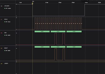

  • Hi Dale,
    We cannot send commands with 16-bit format?As mentioned in datasheet of ADS, word size can be configured as 16bit. My mcu supports max 16bit per frame for SPI comm.
    As an alternate way, I tried to check with MCU SPI setting 8bit per frame & sending the commands byte by byte. As seen from below screenshot there is delay of ~3us between 2 byte & also no reponse on MISO.
    STANDBY
    WAKEUP
    BR
    SN
  • Hi SN,
    I thoughts you were using 24-bit word length, definitely you can use 16-bit word length as long as you set the WLENGTH[1:0] in the MODE register to 01b.
    The response from ADS131M04 ADC can be seen in next frame, not the same frame for sending the command. Below is the timing I just captured:
    1st frame: send the STANDBY command (0x22) on DIN of M04 ADC (MOSI).
    2nd frame: the response (0x22) of the STANDBY command is seen in the first word of this frame on the DOUT (MISO) of M04 , also send the WAKEUP command (0x33) on the DIN of M04 ADC (MOSI) in the same frame.
    3rd frame: the response (0x33) of the WAKEUP command is seen in the first word of this frame on the DOUT (MISO) of M04 while sending NOP (all 0s) on the DIN of M04 ADC (MOSI) to read the data in the same frame.
    BR,
    Dale

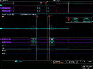

  • Hi SN,
    You said "There is no data i can see on MISO". Can you  show me the timing including the1st and 2nd frame together?
    Can you also share your timing for these codes in 24-bit word (3bytes)?
    • writeSingleRegister(MODE_ADDRESS, MODE_DEFAULT);
    • response = sendCommand(OPCODE_STANDBY);
      response = sendCommand(OPCODE_WAKEUP);
      response = sendCommand(OPCODE_NULL);
    If my understanding is correct, you are connecting the ADC on TI's ADS131M04EVM to your MCU with fly wires? If you still saw "DRDY pin interrupt i get only once & the pin always remains low after that", something was wrong in your connections because by default, you should be able to see the continuous /DRDY pulses after the ADS131M04 ADC is powered up. You can check your hardware connection, or let me know all connections you did.
    BR,
    Dale
  • Hi Dale,
    Yes, I have connected ADC on TIs EVM to MCU:
    TI"s EVM                 MCU
    1. GND---------------> GND
    2. DOUT-------------> MISO
    3. DRDY-------------> GPIO input interrupt on falling edge
    4. SCLK------------->  SPI CLK
    5. CS    --------------> GPIO output
    6.DIG.CLK-----------> Not connected
    7.DIN------------------> MOSI
    8. RESET/SYNC------> GPIO  output
    When I connect EVM to ADS Software tool, DRDY pulses are coming but when i connect via MCU there is no signal change or pulses on DRDY (also checked on scope, its continuous low) .The interrupt only i get once is before ADC init call. If i enable the global interrupts after ADC init there are no interrupts(no signal change) on DRDY.
    Below are timing signals.
    With 24 bit word (3bytes with 8bit frame):
    1. Response for writeSingleRegister(MODE_ADDRESS, MODE_DEFAULT);
    2. Response for response = sendCommand(OPCODE_STANDBY);
    3. Response for response = sendCommand(OPCODE_WAKEUP);
    4. Response for response = sendCommand(OPCODE_NULL);
    With 24 bit word (3bytes with 2x16bit & 1x8bit frame):
    3.Response for response = sendCommand(OPCODE_WAKEUP);
    BR,
    Shraddha
  • Hi Shraddha,
    When you were using your MCU, did you remove the PHI controller card or it was connected to J5 on the EVM? Is there a jumper on JP6? how did you provide the power supplies (AVDD and DVDD) to the M04 ADC?
    No, I have not removed PHI connector, ADS board is powered on via USB even when i interface with MCU.
    Yes, ON JP6, jumper on pin1-2.
    On JP9, jumper on 3v3 LDO, JP7 is open.
    BR,
    Shraddha
  • Hi Shraddha,
    You have to remove the PHI card or remove the series resistors on the SPI bus and control signals on the EVM and wire those signals from the ADC to your MCU directly. If not, the ADC will be interfaced by both your MCU and the FPGA/processor on the PHI controller card. The PHI card can force the SPI/control signals to a different level and mess up your timing from your MCU. When you use your own MCU, you do not need the PHI controller card but you have to provide external power supplies to the EVM.
    - Dale
  • Thanks Dale.
    It worked for me after removing the PHI controller card & giving external supply to the ADC evm board.
