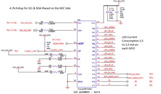

In our design we are going to use TCAL9539RTWRQ1 IC ,we have created the design can you please review it.

    IO Expander Checklist
    Check
    Status (good, okay, verify?)
    Comment
    Local Decoupling Capacitors
     Good
    Generally, a 0.1-uF capacitor is placed on VCC, as close to the device as possible
    Verify the schematic pinout matches the data sheet pinout
    Good
    Sometimes PW and RTW get mixed up
    Check that the pullup resistors are present on the SDA and SCL net within the schematic.
    Verify
    I assume PU resistors are somewhere else in the schematic - please check.
    Unused GPIO pins configured as INPUT’s are biased to either VCC or GND via resistor
     Good - TCAL device
    Most of TI's IO expander portfolio do not include internal pull-up resistors on the p-port pins; the exceptions are PCF8575, PCF8574, PCF8574A, TCA9555|PCA9555, PCA9554|TCA9554, and TCA9554A|PCA9554A and therefore can be left floating.
    An alternative approach is after powering up the device, any unused p-port pins can be set as an output (does not matter if set high or low).
    TCAL agile IO expanders also have the ability to enable internal PU or PD resistors.
    Device address is unique on the bus unless using an I2C switch or I2C MUX to resolve conflicts
    Good
    0x74, verify with other devices on the I2C bus
    If the device has a /RESET pin, bias the pin high (preferably with a pull-up resistor) after powering up.
     Good
    Recommended to have a PU resistor to VCC on this pin. External GPIO works too to keep pin HIGH.
    If the device has a /INT pin and the /INT pin is used, tie this pin to a pull-up resistor.
     Good
    R183 = 10k to VCC, OD output.
