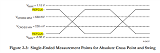

  • I would like to amend this and ONLY concentrate on the REFCLK+ and RECLK- since it was discovered to be the source of our customer's issue. Therefore, ignore everything else for now other than what is below.
    Is there a DC common mode voltage range spec for REFCLK+ and REFCLK- when the XIO2001 is configured to use a synchronous 100MHz Differential Clock?
    Would a common mode of 0.84V be an issue for the XIO2001?
    PCIe spec calls for a Vcross of 250 to 500mV. I do not see this in the XIO2001 datasheet. Is it required to meet this Vcross for the XIO2001 to operate correctly? What would be the ramifications if we did not meet this? Is there a certain amount of known margin that we can violate this by?
    When operating in the 100HMz Synchronous Ref Clock mode, is it expected to use a common source between PCIe link partners (ie same oscillator is used to generate the REFCLK for both PCIe switch and End-Point)? Will the XIO2001 work if a common source clock were not used? What would be the known ramifications is we did not use a common source clock but still used and configured the bridge for a 100MHz Differetial CLock.

  • for clock architectures:
    the Common Clock is the most widely supported clocking method used by commercially available devices. An advantage of this clocking architecture is that it supports spread spectrum clocking (SSC) which can be very useful in reducing electromagnetic interference (EMI) with less stringent reference clock requirements than SRIS. A disadvantage is that the same clock source must be distributed to every PCIe device while keeping the clock-to-clock skew to less than 12 ns between devices..
    for Separate Reference architectures.
       it don't have skew issue, but maybe adding more jitter source.
    Here is the document talking about  PCIe clock  architectures:
