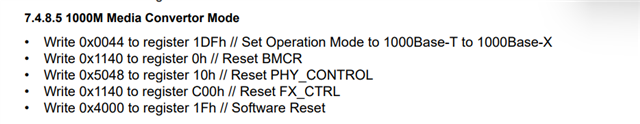

    Could we look at the schematic of the DP83869HM connections?
    If possible, could we also get register dump from 0x00 to 0x1F and 0xC00 to 0xC30 on both PHYs when this issue happens?
    Also, are the fiber and copper link forced to the same speed? If there is a speed mismatch, this can cause packet loss.

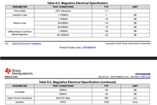

  • Schematic is basic : there are RJ45/Transformer in 1000BASE-TX side and SFP in 1000BASE-X side.
    DP83869HM connected to wifi router:

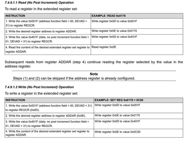

    Could you check the register dump on 0x10 to 0x1F again? They seem to be identical to 0x00 to 0x0F register dump on both PHYs, and they cannot be identical. I am specifically looking for register data of 0x0015 which tracks any receive error count  as I try to isolate at which point the error is happening.
    We would like to ensure that all hardware configurations are according to the datasheet recommendation. If you would like to not post it on the public domain, you can accept my friend request and private message the schematic.

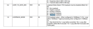

    In addition, could you do a reverse loopback on the second PHY (PHY closer to the switch) at the copper side to see if there are any input errors at the wifi router from the returned packets? Reverse loopback will send the incoming packets back so we can verify where the error is happening.
    Reverse loopback can be enabled by enabling 8h on the register 16h bit 5-2. In addition, auto-negotiation has to be disabled and forced speed on the copper side for reverse loopback to work.
    Please let me know.

  • With reverse loopback there is no error:
    DP83869HM <--- 1000BASE-T ---> Cisco Catalyst 3560-CX switch <--- 1000BASE-T ---> Ethernet tester
    No erreur detected with packet sizes of 64 and 1518 (by default, Catalyst drop jumbo frames).

    I tryed to follow section 7.4.8.5 of https://www.ti.com/lit/ds/symlink/dp83869hm.pdf and I have the same result.
    Wifi router is CW9166E-I and there is the same problem.

    Could you do the PHY's on-chip reverse loopback mode to see if the router sees any packet errors?
    Wi-Fi Router <--- 1000BASE-T ---> DP83869HM

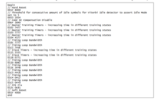

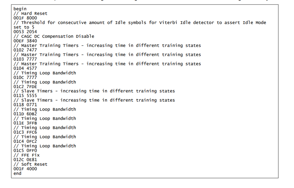

    In addition, could you run your setup with after running these two scripts? Note that the first is the register address and the second is the write value.
    These scripts should help with the link margin.

  • There are always errors in using scripts and this configuration :

    The transformer : https://www.mouser.fr/ProductDetail/Bourns/SM51625EL?qs=1Fv0GIFcFssHdQX2RAfKzg%3D%3D
    Thank you for the transformer information. I looked at the specification for the transformer and it does not fit our recommended specification. Typically, we recommend transformer within 2% tolerance but your transformer has 5% tolerance.
    We recommend transformers like HX5008NL which has 1% tolerance.
    Would you be able to replace the transformer to the recommended specification?
    Below is the recommended specification.
    J
    It works the same way with a 2% transformer.

    Lastly, I noticed that the register dump for 0x00 to 0x1F and 0x20 to 0x3F are identical.
    Dump registers 0x00 to 0xFF:
        |  .0  |  .1  |  .2  |  .3  |  .4  |  .5  |  .6  |  .7  |  .8  |  .9  |  .A  |  .B  |  .C  |  .D  |  .E  |  .F
     0. | 1140 | 796D | 2000 | A0F1 | 0001 | C101 | 006D | 2001 | 6801 | 0300 | 7800 | 0000 | 0000 | 401F | 0000 | F000
     1. | 5048 | AF32 | 0000 | 0000 | 29C7 | 0018 | 0000 | 0040 | 6B00 | 4000 | 0004 | 0000 | 0000 | 0000 | 0012 | 0000
     2. | 1140 | 796D | 2000 | A0F1 | 0001 | C101 | 006D | 2001 | 6801 | 0300 | 7800 | 0000 | 0000 | 401F | 0000 | F000
     3. | 5048 | AF32 | 0000 | 0000 | 29C7 | 0018 | 0000 | 0040 | 6B00 | 4000 | 0004 | 0000 | 0000 | 0000 | 0012 | 0000
    Based on this, I was wondering if you are accessing the extended registers properly. If not, this would mean that any register writes we have done in the past to fix this issue would not have been applied properly. Could you check if the extended registers are accessed correctly? Extended registers are accessed by below:
    Please keep me updated.
    J
    My read and write functions in extended mode are correct; however, I thought they were supposed to be used for addresses above 0xFF and not 0x1F. Therefore, all the read and write actions I performed earlier in the address range from 0x20 to 0xFF are incorrect. I will correct this issue.
    Can you provide me with the exact initialization sequence for the component, along with the recommended corrections I should apply, to make it work in 1000BASE-X media converter mode, so I can redo the test?

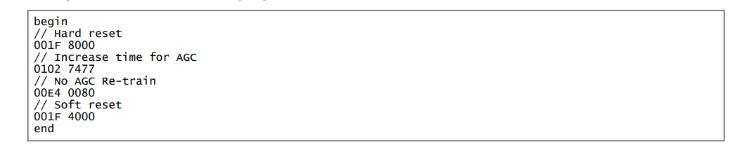

  • HI,
    Could you retry running your system with this script? This script is meant to improve the link margin.
    J
  • Before to run the script, can you confirm I do:
    // Set Operation Mode to 1000Base-T to 1000Base-X
    01DF   0044
    // Reset BMCR
    0000   1140
    // "Advertise 1000Base-T ability" and "Disable Advertise "100Base-T ability"
    0009   0300
    0014   FFFF
    // Disable Advertise "100Base-T ability"
    0004   0001
    // Reset PHY_CONTROL
    0010   5048
     // Reset FX_CTRL
    0C00   1140
    // Software Reset
    001F   4000
  • For register 0053h, value to set isn't 2053h?
    Sorry for the delayed response.
    Yes, you are correct on the script above. There is no need to disable 100Base-T advertise, but it wouldn't matter.
    For 53h, feel free to use either 2054h or 2053h. 2053h is the minimum IPG the device can tolerate. We would not be able to go lower than 2053h since that is known to not work.
    J
    With the script, DP83869HM doesn't link for the fiber side.

    Could you then follow the script in the datasheet without disabling any advertising for 100Base-T?
    This is the script:
    And then apply the other scripts and see if the fiber link can still not happen.

    When I use scripts which modify link margin, the fiber optic interface does not link even if I don't disable advertising 100BASE-T. But If I disable link loss pass through feature, this interface links.

    Initialization script :
    // Disable link loss pass through feature.
    01EC   1FF5
    01DF   0044
    // Reset BMCR
    0000   1140
    0009   0300
    0014   FFFF
    0004   0001
    0010   5048
     // Reset FX_CTRL
    0C00   1140
    // Software Reset
    001F   4000
    // Hard reset
    001F   8000
    // Threshold for consecutive amount of Idle symbols for viterbi Idle detector to assert Idle Mode set to 5
    0053   2054
    // CAGC DC Compensation Disable
    00EF   3840
    // Master Training Timers - increasing time in different training states
    0102   7477
    0103   7777
    0104   4577
    // Timing Loop Bandwidth
    010C   7777
    01C2   7FDE
    // Slave Timers - increasing time in different training states
    0115   5555
    0118   0771
    011D   6DB2
    011E   3FFB
    01C3   FFC6
    01C4   0FC2
    01C5   0FF0
    // FEE Fix
    012C   0E81
    // Soft reset
    001F   4000
    // Hard reset
    001F   8000
    // Increase time for AGC
    0102   7477
    // No-AGC Re-Train
    00E4   0080
    // Soft reset
    001F   4000
  • With a 50-meter cable, the equipment works in the same way if I don't disabling advertising 100BASE-T.

    Could you try
    0053   2053
    Instead of 0053 2054? This is supposed to lower the minimum IPG required on the PHY and may help with the link margin, but this is the lowest setting we can do.
