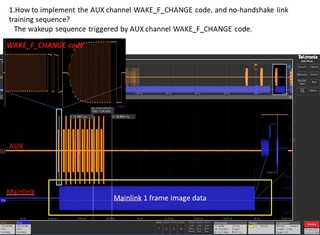

I use SN65DSI86EVM connect to our EVB (SSD2828 mipi bridge), the panel module can not be display.
The SN65DSI86 initial code and AUX & Mainlink waveform is list as below:

How to implement the AUX channel WAKE_F_CHANGE code, and no-handshake link training sequence?
   The wakeup sequence triggered by AUX channel WAKE_F_CHANGE code.

  • hi sir,
    We still can not light on the panel .
    Our test platform is FPGA sending images to MIPI bridge (SSD2828),  MCU (8051) sending I2C to SN65DSI86.  After MCU sends initial code to SN65DSI86, it will no longer send I2C to SN65DSI86 EVB.
    we found that there is no signal toggle on the aux channel between the main link transfer image content.

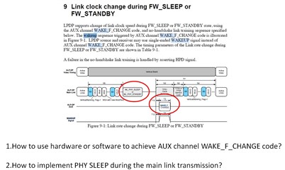

    We have two question:
    1.How to use hardware or software to achieve AUX channel WAKE_F_CHANGE code ?
    2.How to implement PHY SLEEP during the main link transmission?

  • Hi Jackson,
    Could you please tell us about the WAKE_F_CHANGE and PHY_SLEEP code and where this diagram is from. If this is from the display specifications, then we would need more details about what needs to be implemented.
    Are they trying to pass I2C over aux?
    If you are only trying to disable video data bring passed to the DisplayPOrt output, you can use the 0x5A[3] VSTREAM_ENABLE bit.
    From the DSI bridge perspective we just require using the initialization sequence and configurations explained in the datasheet. And for an initialization script you can use this calculator tool: https://e2e.ti.com/support/interface-group/interface/f/interface-forum/1382976/faq-sn65dsi8x-programming-tools
