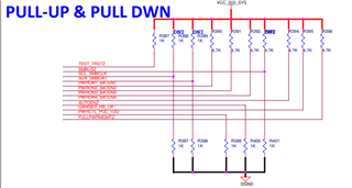

Dear Team,
I have attached the USB hub schematic design based on the part number TUSB4041IPAPRQ1, Kindly review the attached schematic and share your feedback.

Hi Vandana :
I'm working on schematic review and will be complete by tomorrow.

Hi Vandana:
Here is my comment for schematic:
1: TEST pin need to be PD to Gnd with 4.7k.
2:SMBUS is low, do you need SMBUS mode? if not, just leave this pin floating.
3: to enable power switching, FULLPWRMENT should be PD
PWR_POL should be Pulliup for high enable vbus switch
GANGed pin should be PD for individual ports.
No need to pullup PWRONx pin if battery charging is not needed.
