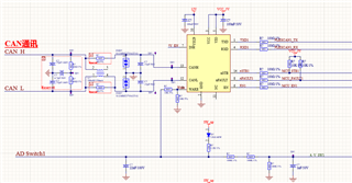

Hi team,
Could you please review the schematic and give some comments? Thanks!
Ivy
  • Hi Ivy,
    The ESD diode and bus filters should be placed near the connector. It is not recommended to put any component between CMC and the IC. That being said, CMC should be placed nominally between the terminations and IC.
