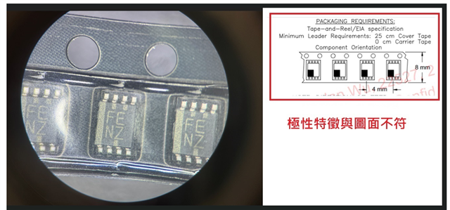

Hi Team,
My customer bought some TXS0102DCUR chips

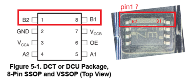

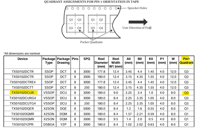

However, the appearance of pin 1 orientation is different from the datasheet.
Could you help confirm the part marking is correct or not of this part? Please also help confirm the pin 1 orientation.
