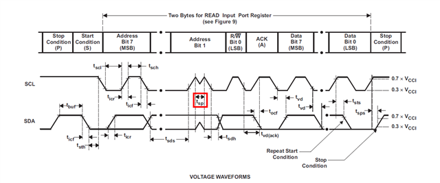

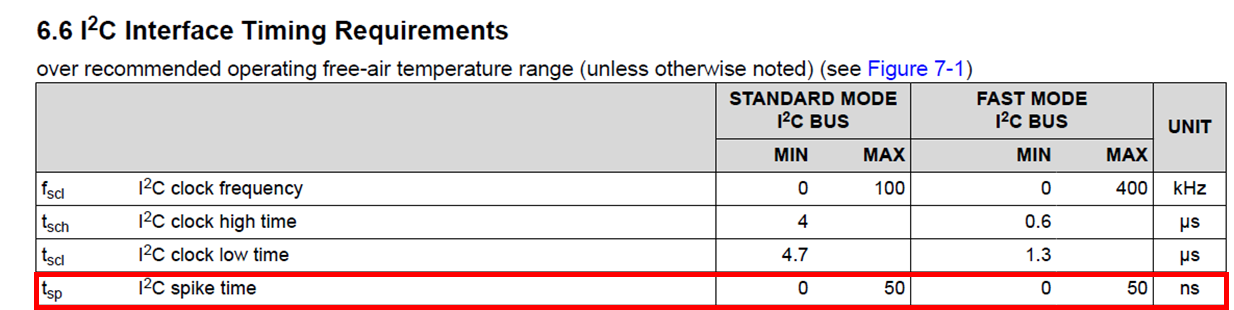

I have a question about the timing requirements of the I2C interface.
I would like to confirm the definition of tsp (I2C spike time).
Does it apply when the voltage level drops due to noise, causing SCL to fall below VIH (0.7 x VCCI)?
Also, spikes do not usually occur, right?
(It is desirable that spikes do not occur, right?)
  • Pulses (either high or low) that are shorter than 50 ns are ignored. (This is a requirement of the I²C specification.)
    I²C signals are not very well protected against noise, so spikes might occur in practice.
