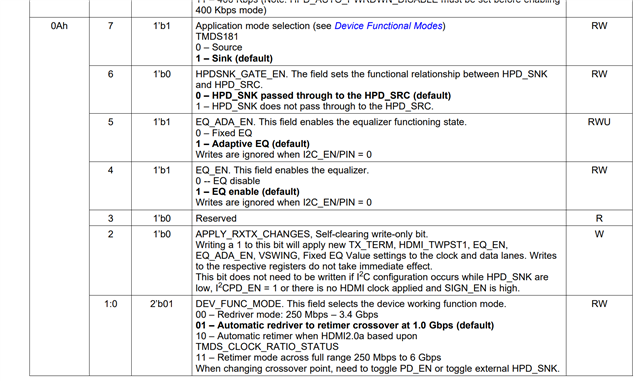

HI team,
do you have a hardware and software guide for configuring TMDS181 as redriver mode? Thanks!

You just need to set the TMDS181 DEV_FUNC_MODE bit [1:0] to 0x00 for the re-driver mode.
