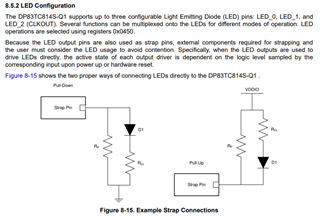

In my previous posts also I have asked regarding this where i didnt get correct feedback,
I am designing an Ethernet in RMII slave mode which would be interfacing with STM microcontroller, For the LED pins in DP83TC814R, I want to use it for both blinking LED and the GPIO strap settings, how this should be taken care in schemtics?
in the hardware checklist the strap settings are highlighted for LED, what will happen if i connect LED here? which path should be enabled ? & where should CLKOUT pin be connected?
