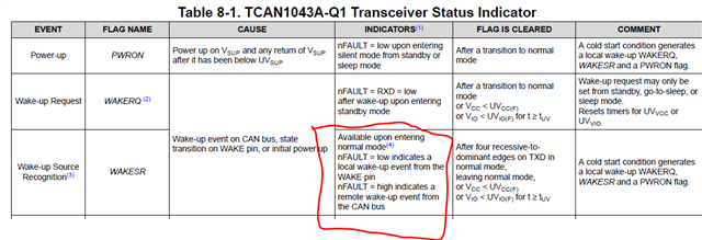

We are using TCAN1043A-Q1 in our project.
There are 2 wakeup sources in our project one is CAN and another one is RTC. Interrupt from RTC chip is connected to WAKE pin of TCAN1043A-Q1.
The RTC chip is configured to generate an edge upon alarm expiry. The requirement is to wakeup the cluster and write into NVM and go back to sleep.
Could you please share the procedure to detect the wakeup by WAKE pin?
