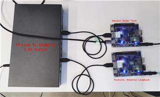

customer found the DP83867 packet loss issue and did some test.
The connector of RJ45 they used is 8207S-81000075-1 including the  transformers
1. test FPGA MAC and DP83867CR MII lookpack and digital loopback, no packet loss. It seems not RGMII issue for packet loss
2. connect using 2pcs DP83867CR board, and set reverse loopback mode for 1 board, no packet loss issue occurred.
3. Bridge 2pcs DP83867 boards with TP-Link TL-SG108 (1G Switch), it works fine
4. Bridge 2pcs DP83867 boards with ZYXEL XGS1250-12 (Multi-Gig Switch) or TP-Link TL-SG108-M2 (2.5G Switch), there was around 0.5% packet loss

    For the Bridge 2pcs DP83867 boards with ZYXEL XGS1250-12 (Multi-Gig Switch) or TP-Link TL-SG108-M2 (2.5G Switch), there was around 0.5% packet loss,
    • Can you please share a picture of the overall connection?
    • If you enable DP83867 reverse loopback, are you seeing any packet loss?

  • Hi David,
    Thanks for your questions! Here's what we found in our tests and the info you asked for:
    Our test setup: one DP83867 board is configured as a reverse loopback fixture, and the other acts as the DUT for testing.
    1. Here's the overall connection diagram.
    2. When the reverse loopback fixture is connected directly to the DUT, we didn't see any packet loss.

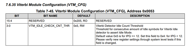

    With the TP-Link TL-SG108-M2 switch, are you not seeing any packet loss improvement with both scripts? Is it possible that you can try with a 35m, 45m, or 50m Ethernet cable, do you see the packet loss gets worse or better with the longer cable?
    Also, can you write to register 0x53 bit [3:0] to change the inter-packet gap and see if it solves the packet loss issue? Please note register 0x53 is an extended register and you have to use extended register access to write to this register.

  • Hi David:
    Thanks for following up! Regarding the TP-Link TL-SG108-M2, we have some further test results for you:
    1. The script from Section 3.1 definitely helped, reducing packet loss from 0.6% down to 0.15%.
    2. However, the script from Section 3.2 didn't show any improvement.
    3. For your cable length question, comparing a 15m Ethernet cable to a 0.5m one, the packet loss increased by roughly 0.03% to 0.09%.
    4. We also tried tweaking the inter-packet gap at register 0x53. After changing it from the default 0x5 to 0x4, packet loss dropped from 0.69% to 0.18%. Just a heads-up, this setting is actually included in the Section 3.1 script, so the results are quite similar.

    Can you change the inter-packet gap to a value of 0x3, basically write 0x2053 to register 0x53 and if it improves the packet loss?

  • Hi David,
    Thanks for your suggestion! We've tested with an inter-packet gap of 0x3, and here are the results:
    After changing the inter-packet gap to 0x3, the packet loss rate on the TP-Link TL-SG108-M2 significantly improved, dropping to below 0.0001%! However, the datasheet doesn't explain the meaning of the 0x3 value. Do you happen to have any more detailed information on this?

  • Jim
    It is good news that you are seeing the packet loss drop to below 0.0001% with Inter Packet Gap(IPG) set to 3. With packet loss drop to below 0.0001%, is this an acceptable solution?
    The Inter Packet Gap refers to the minimum time allowed between the transmission of Ethernet frames. DP83867 supports the expected 12 byte IPG at the MDI as well as lower amounts in some conditions. This number comes from IEEE802.3 section 4.4.2 which sets out that the minimum IPG for a transmitted frame is 12 bytes on the TX lines of the MAC. When the data comes to a PHY, there is a handoff of clocking domains and thus there is potential for IPG to be 11 bytes when sent on MDI line. In cases where the IPG is smaller, Reg 0x53[3:0] can help increase margin in these applications with no drawback on performance. The lowest that this can be set is to 0x3 (default is 0x5) which has been seen to support 11 IPG.
    What this tells me is that the switch is too aggressive, it is transmitting with a smaller interpacket gap to achieve higher data transfer rates which can lead to packet loss. Is there a way you can lower the switch data transfer rate?
