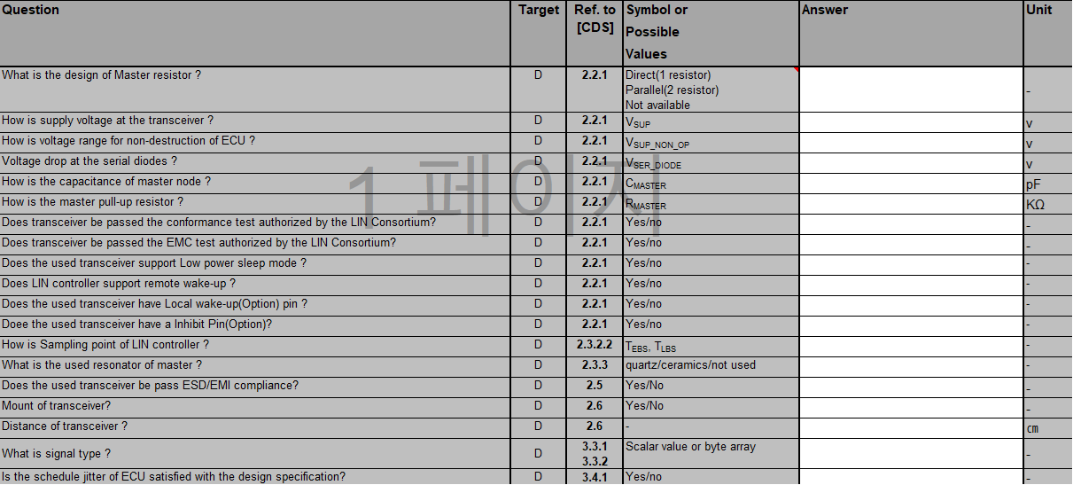

My customer sent me some questions about TLIN1021ADRQ1 from their end customer. Could you check these questions?
1. How is Sampling point of LIN controller ?
- Symbol or Possible Values : TEBS, TLBS
2. How is Slave node bit rate tolerance with use of synchronization before synchronization?
- Symbol or Possible Values : FTOL_UNSYNC (%)
3. How is Slave node bit rate tolerance between two slave nodes ?
- Symbol or Possible Values : FTOL_SL_to_SL (%)
4. What is signal type ?
- Symbol or Possible Values : Scalar value or Byte array

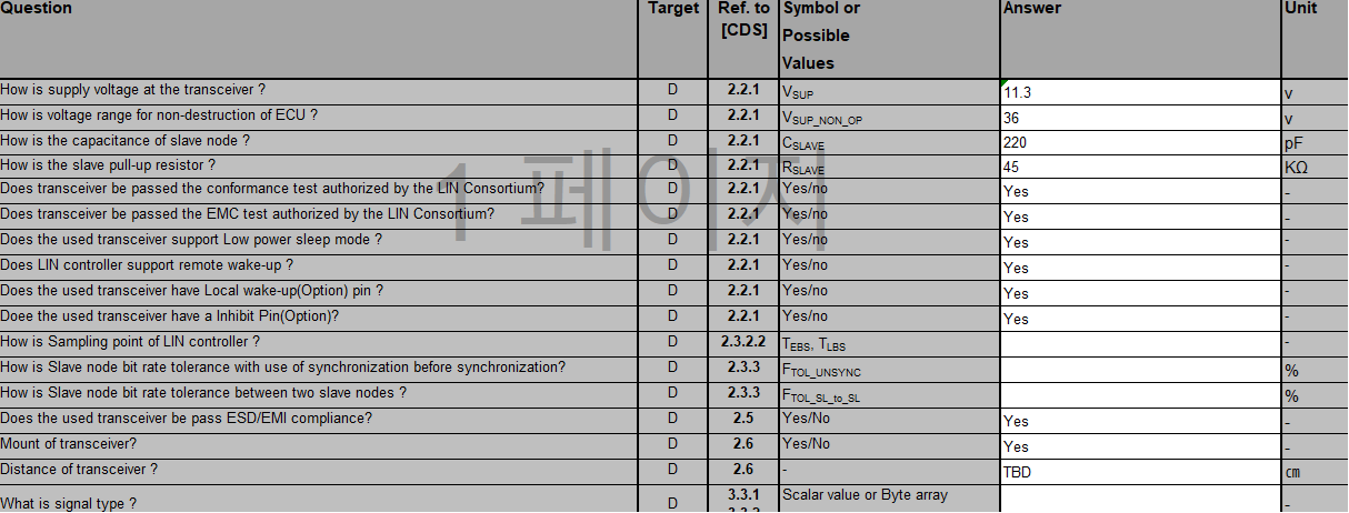

    Actually these questions are came from their end customer. They have to fill out the sheet regarding to specification.
    These questions are divided into master side and slave side. My customer makes slave side product.
    Could you check it again for slave side questions?
    I also attach the question of master's side for your convenience.

  • Hi Chase,
    • The FTOL_UNSYNC capability depends on the controller’s implementation
    • FTOL_SL_to_SL  depends on the firmware and not the TLIN device.
    • TLIN device is for the physical layer and do not interpret signal types. This is setup in the LIN stack or when configuring the LIN frames per the LIN protocol layer I.e., the software/firmware layer, thanks.
    Please check with the controller per your enquiries as the LIN device pertains to the physical layer only, thanks
