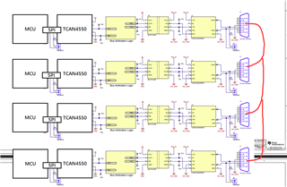

    One more thing I’d like to check with you is the application topology.
    Based on the block diagram from the Isolated CAN FD Repeater Reference Design, I assume it should support chaining on the same CAN bus. Also, the end device should be replaceable with a TCAN4550 and connected to a MCU as shown below, right?
  • Hi Paul,
    Multiple devices are always "chained" on the same CAN bus and this is the normal application for CAN, so I would say yes.
    Also, yes an MCU and TCAN4550 can be connected through SPI and to the Bus Arbitration logic when used in a test mode to bypass the internal CAN FD transceiver.

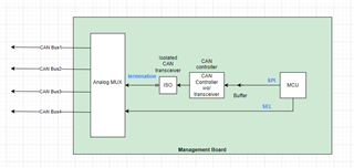

  • Hi Johathan,
    I'd like to design the system with a "master-polling → response → silent" structure, where the CAN bus is selectively enabled or disabled via a MUX. I assume the termination would be placed behind the MUX. Could you recommend a solution to ensure the CAN bus remains in a high-impedance state when disconnected? Additionally, what potential risks should we be aware of in this approach?

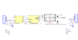

  • additional for Isolated CAN FD Repeater Reference Design (Rev. A)
    my understanding is it should be able to replace with a ISO1044 as below, is it correct?
  • Hi Paul,
    Yes I believe your understanding is correct.  The ISO1044 device integrates both the isolation and CAN transceiver into a single device.  I believe the reference design was done prior to the development of the ISO1044 or other isolated CAN transceiver which is why it has both a separate isolation and CAN transceiver.
