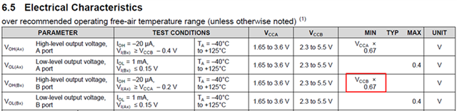

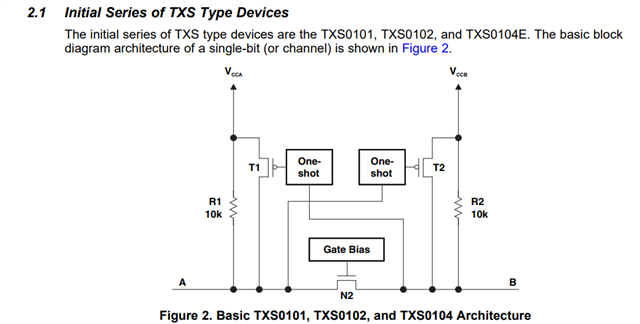

I would like to check what factors judge the VOH? (VCCB*0.67)
What condition would let VOH = VOH(mini) (0.67VCCB)?
According to the to the app note, it looks like that when T2 turn on, B port should be VCCB, not sure why VOH would become low. Feel free to let me know if I have any misunderstanding.
https://www.ti.com/lit/an/scea044/scea044.pdf?ts=1749548419971&ref_url=https%253A%252F%252Fe2e.ti.com%252F
