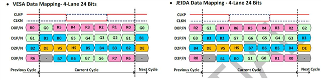

I want to confirm if SN65DSI85 can support 2 lanes MIPI transmit to  4 lanes LVDS (24bits data).
Receiver expected data.
Roy
  • Hi Roy,
    Yes, the DSI85 can support 2 DSI channels, and the number of DSI data lanes (1 to 4) can be as needed.
    The DSI85 device supports LVDS for:
    - single or dual channel (Channel A and B)
    - 24 bpp or 18 bpp supported (7.4.5 LVDS Output Formats)
    - output format can be VESA or JEIDA format (7.4.5 LVDS Output Formats)

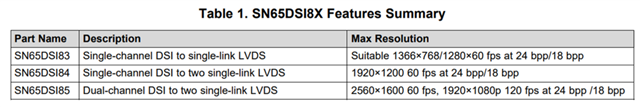

    And just some additional notes:
    - There are two versions of the device. The SN65DSI85 BGA package and SN65DSI85-Q1 automotive grade package
    - depending on number of DSI channels and LVDS channels required, you can also consider using SN65DSI83, SN65DSI84, SN65DSI85
