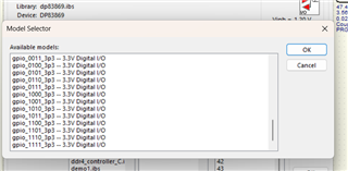

We are using the AM6442BSFFHAALV processor and the DP83867IRRGZT PHY, and we would like to confirm few GPIO pins RX_CLK & RX_data got a model select with a binary ID, what is the meaning of it. Please, explain and which one to be used. I am attaching the model selector window for our reference. Kindly, help us slot out this issue.

    The 4 digitals in the middle of each model corresponds to the MAC_IMPEDANCE_CTRL bits (Register offset 0x170h). The MAC_IMPEDNACE_CTRL bits is the impedance control for MAC the I/Os: Output impedance approximate range from 35-70Ω in 16 steps. Lowest being 1111 and highest being 0000. So for instance, the GPIO_1000 would be around 50 Ohms.
    The 1.8V, 2.5V, and 3.3V corresponds the DP83869 VDDID and depends on your design. It is the I/O power which can be 1.8V, 2.5V, or 3.3V.
    David
    The different models available correspond to the different impedance settings of the device. DP83869 has the ability to change output impedance to counter non-optimal layout, which can impact overshoot/undershoot as well as setup and hold times. This correlates to Reg 0x170[4:1]. You can simulate based upon which configuration you would like.
