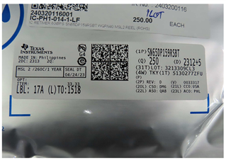

Part Number: SN65DP159
Please confirm MSL level in document = MSL 1
https://www.ti.com/product/SN65DP159/part-details/SN65DP159RSBT
But on label = MSL 2
We made improvement to the DP159 MSL level in 2024, so the datasheet reflects the latest DP159 MSL level.
David
