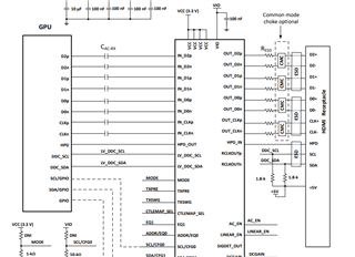

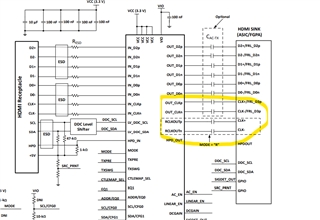

Can the same HPD method can be used for TMDS1204 as used in TMDS181.
For Source side can the RCLK can be used depending upon HDMI1.4/2.0 and outclk for FRL ?
Irfan
Irfan
Please see my response below
Yes, and this is how I did on the TMDS1204 EVM as shown below. The HPD_OUT is the HPD output from TMDS1204.
The RCLK is an output only and it is only for HDMI1.4 and 2.0, so I am curious how you want to use RCLK for FRL, do you have a block diagram to show the proposed implementation?
David
1) While sending the TX HDMI 2.1 all the data can be out from D0-D2 and 4th data from Out CLK , but when it is HDMI 2.0 I mean when it fall back to HMDI 2.0 then data will be out from D0-D2 and can the remaining i.e. CLK can be sent through Out CLK or RCLK?
2) What to do with SIGDET pin when not used ? Can be left floating?
3) Can you please verify the attached image for pin-strap mode and also help me with the Default mode of each pin.
Irfan
Irfan
When the fan-out buffer feature is enabled, the TMDS1204 will output the HDMI clock on RCLKOUTp/n when operating in HDMI 1.4 or HDMI 2.0. The OUT_CLKp/n will be disabled. When operating in HDMI 2.1 FRL mode, the TMDS1204 will output FRL data3 on OUT_CLKp/n. RCLKOUTp/n will be disabled.

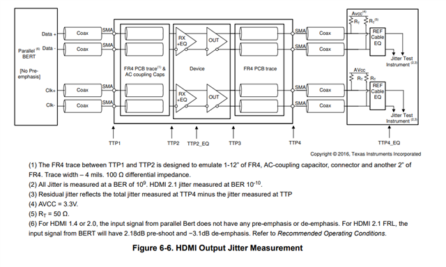

Irfan
The propagation delay at TTP4 is min of 90ps and max of 220ps.
David
David,
1) What does TTP4 means, and what should i consider the typical value of delay.
2) In previous HDMI 2.0 the data lines along with the clock line we used to group length match it together, now that the HDMI 2.1 has data integrated with clock and also there is an RCLK_OUT out pin in TMDS1204 re-driver whether we need to do the group length matching along with the D0-D3 data lane or length matching for D0-D3 is enough? Is it required for
Irfan
Irfan
Please see below for the TTP4 definition. From our lab measurement, the typical value is around 160ps.
