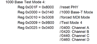

Test modes 1, 2, and 3 work, but 4 and 5 do not.
Is there something wrong with the settings?
Test Mode 4
In this case, Low is output all the time.

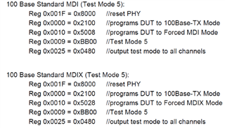

Test Mode 5
In this case, the same result as test1 is output.

  • Hi Ryu-san,
    For test mode 4, does the customer see no output even when register 0x0025 is set to 0x0480? This sets output to come out to all channels.
    For test mode 5, 0x0009 does not support 100Base-TX as that register is meant to send out 1000Base-TX signals.
    What is the customer trying to do with test mode 5?

  • Hi J-san,
    I have corrected the test mode 4 with the information you provided, but it did not improve.
    I think the environment is not bad because I was able to perform test mode 4 when I used a PHY from another company.

    The following changes were also made to test mode 5, but did not improve it as well.
      Reg 0x1F = 0x8000
      Reg 0x0 = 0x2100
      Reg 0x10 = 0x5008
      Reg 0x1F = 0x4000
    I think I can run test mode 5 with 100base because the following document seems to run test mode 5 with 100base, but is it wrong?
    https://www.ti.com/lit/an/snla239d/snla239d.pdf

  • Hi Ryu-san,
    Are there any other possible causes?
    Has the PHY responded to other register writes? If you read the register values back after writing, does the register read match what you have written?
    This document specifies generating 100base idle mode signal, not test mode 5.
