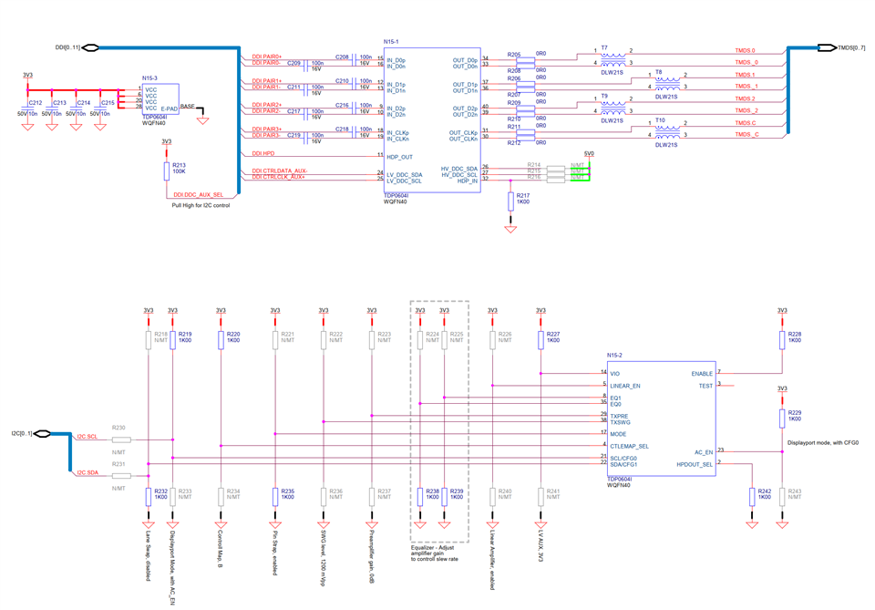

    You can use TDP0604 and DP159 without DDC, but both the source and TDP0604/DP159 have to be manually configured to support the particular resolution.
    Looking at the schematic, below are my comments:
    1. Remove R228 and add a 0.22uF pulldown capacitor
    2. Remove R229 and populate R243
    3. Populate R240
    4. Need to tune R238 and R239 depends on the output signal quality
    5. Remove R219 and populate R233
    6. Leave both LV and HV DDC floating since you are not using DDC
    7. Pull HPD_IN to 5V
    If you probe the TDP0604 clock output, do you see a clock output? And does that clock output frequency match with the targeted resolution?
    David
  • Thank you for your reply David.
    With respect to your points:
    1) Removing R228 would never enable the device, so this cannot be right? Section 9.2.1 of the datasheet specifies a 100nF cap to GND, we have tried to add this to our PCB as well.
    2) Pulling AC_EN down will make the TDP0604 be DC coupled. How is this a good idea when the display source is DP++?
    3) Pulling LINEAR_EN low is recommended for source application as per table 8-4 so I see the point in doing this.
    4) We can tune these when we get video through. It is more related to optimization, currently we get no video through.
    5) Pulling GFG0 low together with AC_EN low, as suggested in your point 2, makes HDMI termination open per table 8-13. What is the point of this?
    6) Understood
    7) Is this required for the TDP0604 or the display source?
    Currently we do not see any activity on the clock output. We are also in communication with the manufacturer of the COMe module, as the module may require a response on the DDC lines to start video transmission.
    We are also investigating if adding an EEPROM on our PCB and connecting the DDC lines of the TDP0604 (on the HV side) could be a solution. This EEPROM would then need to be placed on I2C address 0X50 and contain EDID (with our prefered display resolution) for the COMe to read. This will basically simulate an external monitor.  Do you think this is a better solution than not connecting the DDC lines?
    Lars
  • Hi Lars,
    Please see my response below
    1) The TDP0604 EN pin has a internal 250k pull-up to VIO, so you don't need the external pull-up resistor. Along with the external pulldown capacitor, this creates a passive reset circuit and capacitance can be changed to decrease/increase the reset timing depending on the VCC power ramp up time.
    2) The TDP0604 input can support both DC and AC coupled input without any control. The AC_EN pin controls the DC or the AC coupling of the TDP0604 output, so in this case, we want to set AC_EN pin low since TDP0604 output is DC coupled.
    5) Pulling CFG0 and AC_EN both low will change the termination depending on the pixel clock frequency. But termination will impact the signal quality, it will not impact the issue of video not going through.
     7) Please see the table below for the TDP0604 Power Modes. When EN is high, it is important that HPD_IN needs to be driven high as well for the TDP0604 to be in normal operation mode. Otherwise TDP0604 will be in power down mode with all outputs in Hi-Z state.
    Please also note that the HDMI TMDS is a current mode driver. When you are measuring the CLK output and with the output being DC coupled, you need to connect the output to a 50ohm termination network to 3.3V in order to see a signal.
    If the COMe module does require a read of DDC lines to start the video, then you can use an external EEPROM and I don't see an issue with your proposed implementation. You can implement the EEPROM as shown in below block diagram. The DDC buffer must be enabled and the LV DDC pins must be floating. This connection is supported in pin-strap mode when MODE pin is "0" or "1". In I2C mode, the DDCBUF_EN register must be set to enable the DDC Buffer.
    David

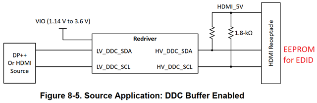

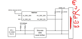

    With respect to the EEPROM, could we use the configuration in Figre 8-5 of the datasheet? This will save us the external level translator.
    The implementation will then look something like this:
    We then expect to close the connections in X14 on the HV side to the EEPROM. Will this be a feasable solution?
    I do not see an issue with your proposed implementation. For the TDP0604 LV_DDC, it has internal pullup, so no external pullup is required. If you are snooping on the LV instead HV side, please disable the TDP0604 DDC buffer.

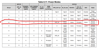

    An additional question: From table 8-17, it seems that row 5 is a power mode where the device does not power down but keeps both RX and TX active at all times. Is this correct? It seems that HPD_IN is don’t care in this situation (I guess the registers must be written over I2C in this case.
    Yes, this is using I2C register to ignore HPD pin (never goes into Low Power mode) and also disable the Standby mode when there is no input signal being present at IN_D2 or IN_CLK. So basically it forces TDP0604 into the always active state with PD_EN bit = H.

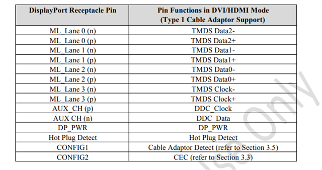

    Please also check the COMe Module DDI interface lane order and make sure the lane order followed the DP++ spec as shown below.
    David
  • I have just checked and I can verify that the COMe DDI lane order is according to the spec (e.g. DDI lane 0 + corresponds to ML Lane 0 (p)). In the design, DDI lane 0 is connected to TMDS lane 2, DDI lane 1 is connected to TMDS lane 1 and DDI lane 2 is connected to TMDS lane 0. DDI lane 3 is connected to TMDS clock. This seems OK from my point of view. Please note that the TDP0604 implementation on this board is functioning correctly. Since I am using the same implementation for the DVI connector, I am confident that the connections to the connector are correct for the DP159. Are we in agreement that the DP159 should output video in this case?
