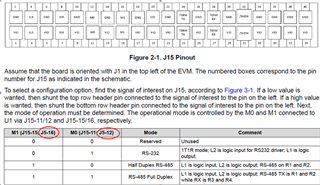

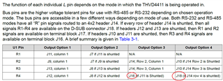

1. J5-16, J5-12 should be J15-16, J15-12??
2. There is no J18 on the EVB, so it should be J10?
3. Full duplex RS485 should be 11?
4. There is no J16 and J18 on EVB

  • Hi Wayne,
    Thanks for bringing these typos to our attention. Your comments are correct, and I will work on updating this.
    THVD4411 does not have auto direction control. The DIR pin is used to switch from transmitting to receiving.
