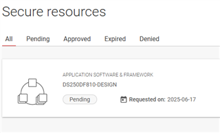

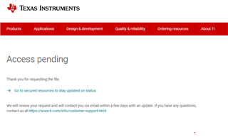

HI,
How can I download the profile of DS250DF810?
I need the profile(.exe) for GUI connection.
  • Hi Lee,
    Please request using link on the product page.
    Drew
  • and
    "Request now" click.
    Capture Screen.
  • Hi Lee,
    You should have access shortly.
    Drew
