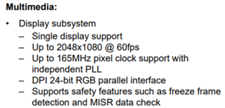

Will the 913A be able to accept data input from Sitara? Does 913A support DPI?

For this application, a display serializer/deserializer device would be recommended. DS90UB925Q is one such serializer that has a parallel 24-bit interface.
Carter
Hi Carter,
The OEM is requesting a camera serializer here, there will be a 954 or 960 on the other side of the link, so will 913A work here?
Katie
Hello Katie,
913A will not work here as there are 24 data output pins on the AM62A and only 12 data input pins on the 913A.
