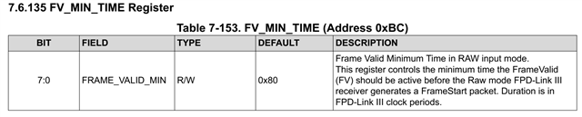

    If the PCLK frequency is set to 37 MHz, there will be a signal at the CSI UB954 input, but this signal will randomly disappear.
    Are there any recommendations for the PLCK frequency range with a 48 MHz reference generator?
  • Hi IEvan,
    I looked at your provided register values. Now I can see you are receiving data from the camera, but very low resolution. Is this expected?
    0x33 - [5:4] = 10 which is 2-lanes. If you want 4-lanes change to 00
    0x35 = 00 which means there is no CSI data at the DES output.
    0x4E = 0x14 - Buffer error
    0x4F = 0x34 = 52MHz
    LINE_COUNT_xx [0x73:0x74] = 0x001C - 28 lines!
    LINE_LEN_x [0x75:0x76] = 0x029A - 666 x3/3 = 444 pixels/line
    You can't use 37MHz PCLK this is below the minimum supported by the SER. The UB933 supports min 37.5MHz by 12-bit mode and min 50MHz by 10-bit mode.

    We managed to get data on the CSI line.
    We decreased the value in the register
    FV_MIN_TIME (Address 0xBC)
    The data on the CSI line can now be seen by the oscilloscope, but our system does not perceive this data.
    We do not receive an image.
    For the FV_MIN_TIME register, how to correctly determine the value that needs to be written to it?

  • Hello Ivan,
    For your use case, RAW12HF, you should program 195 (Hex 0xC3) to this register.
