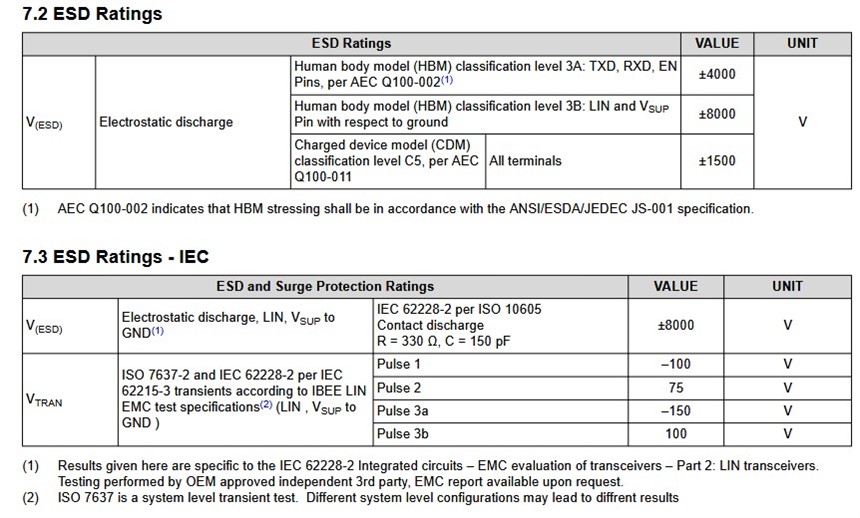

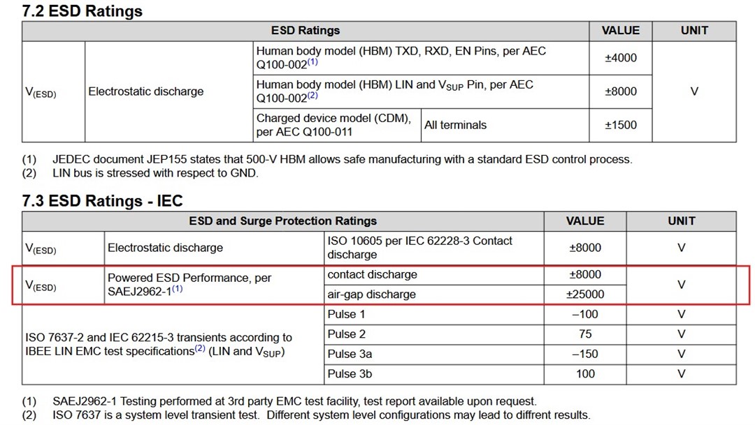

Could you provide the SAEJ2962-1 testing value for TLIN1029A-Q1? I can find the test result in the TLIN1029-Q1 datasheet, but the TLIN1029A-Q1 does not provide it.
TLIN1029A-Q1:
TLIN1029-Q1:
