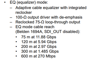

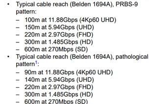

Hi team,
In a related post, there was a comment that LMH1229 has improved cable reach performance compared to LMH1297.
Could you please explain specifically how LMH1229 has improved compared to LMH1297, and to what extent the performance has improved?
Kyohei
  • Hi Kyohei-san,
    The improvements are as follows:
    LMH1297:
    LMH1229:
    The improvements are mostly from the fact that LMH1229 was designed to be an equalizer and LMH1297 was designed more as a device with multi-functionalities.
