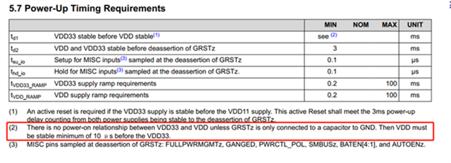

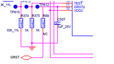

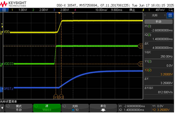

could you help review the power sequence, customer just connect the cap in the GRSTZ, is below power sequence ok?

Power on sequence looks good.
Best
Brian
