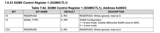

The DP83867E SGMII EVM evaluation-board has an SGMII-interface consisting of one transmit differential lane, one receive differential lane and one clock differential lane. I would like to remove the differential lanes for the clock so that the SGMII-Interface will embed the clock in the data-streams.  How could I achieve this configuration?  Please let me know which all registers of DP83867E have to be modified and what are the modifications,

    DP83867 SGMII interface is capable of working as a 4-wire or 6-wire SGMII interface. Register 0xD3 controls the SGMII configuration either as a 4-wire (without differential clock) or 6-wire (with differential clock). The default SGMII connection is through 4-wire.
