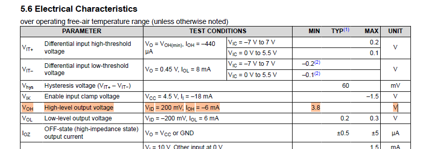

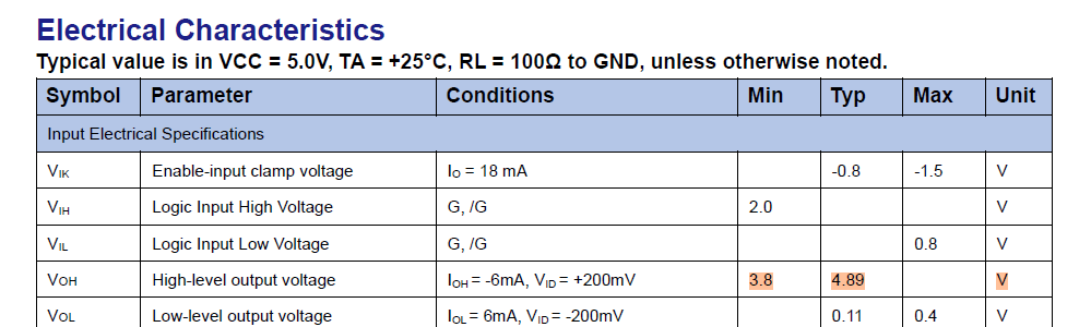

My customer is using AM26C32/TPT4032 for connecting with DSP.
Voh of AM26C32 is 3.8V, which is 4.8V in TPT4032. For competible design, they use two resistors to divide the Voh.
Customer wants to know what the Voh value if the Ioh is <1mA. In datasheet you can see, it is 3.8Vmin when Ioh is 6mA.
