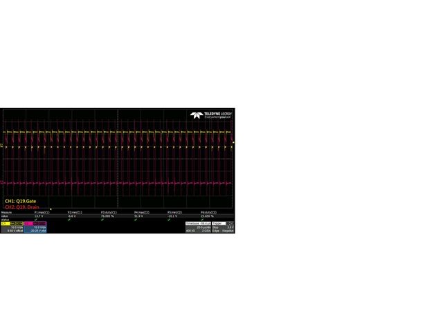

Originally, the 9V input could only reach 12V/120W, but now it can reach 12V/170W, and the goal is 12V/200W.
R21: 4.99 k→3.3 k
R21: 120 k→150 k
R22: 80.6 k→56 k

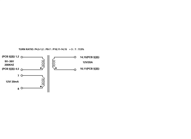

Is there any room for improvement? What turns ratio can the transformer be replaced with?
Attachments include Qmain waveform & current transformer specification
This figure shows Qmain.Gate & Qmain.Drain waveform, 9Vin, Load: 13A
This figure shows the transformer specifications currently in use
