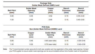

What is the recommended pads size for TLK10232? The Ultralibrarian footprint available on product page are 0.7mm. But in the eval board, they are 16mils (0,4064mm).

This will depend on whether you use SMD or NSMD pad. I'd recommend using the recommendation from the application note below.

Thanks for the information. I will apply 0.55mm pads with 0.7mm soldermask opening
