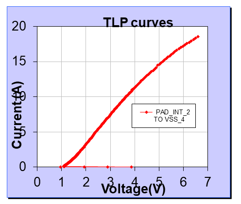

We have a requirement to simulate the design on surge events , since you don't have spice model for the ESD protection part we are adding the ESD protection circuit externally to replicate it.
If we know what the Internal ESD +ve & -ve clamping voltage is designed for it will be helpful for selecting the ESD diode. If you have any test data for this this part or similar Ethernet Transceiver part you can share with us.

Thank you for your patience. The ESD behavior may be very difficult to model, but my design team has provided the IV curve of the diodes within the device. Please note that this data may not be the most accurate due to package and board parasitics, but can be used to do relative analysis.

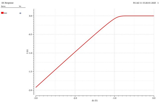

Can you confirm will the IV curve be the same on the -ve voltage as well.

Below is the I/V curve for negative DC. Please note this has the same disclaimer of relative analysis only as the initial graph I provided.

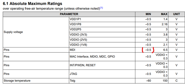

Thanks for inputs, below are my queries.
1. From the graph i can observe the diode starts conduction around -0.8V. From the data sheet the absolute maximum voltage on the MDI pin is given as -0.5V. So any negative surge between-0.8v and -0.5V can it damage the MDI pins?
2. The clamping voltage from the graph is looking like more than -0.8V, is it need to be less than -0.5V?
Thanks & Regards
Sudharsan R
Whenever the voltage exceeds -0.5V, this violates the Absolute Max Rating and opens potential to damage device. I would worry less about how the internal clamping voltage plays around with the absolute maximum and worry about this rating if being meet with consistent signaling (think undershoot/overshoot). Again, this graph is relatively inaccurate due to package and board parasitics.
