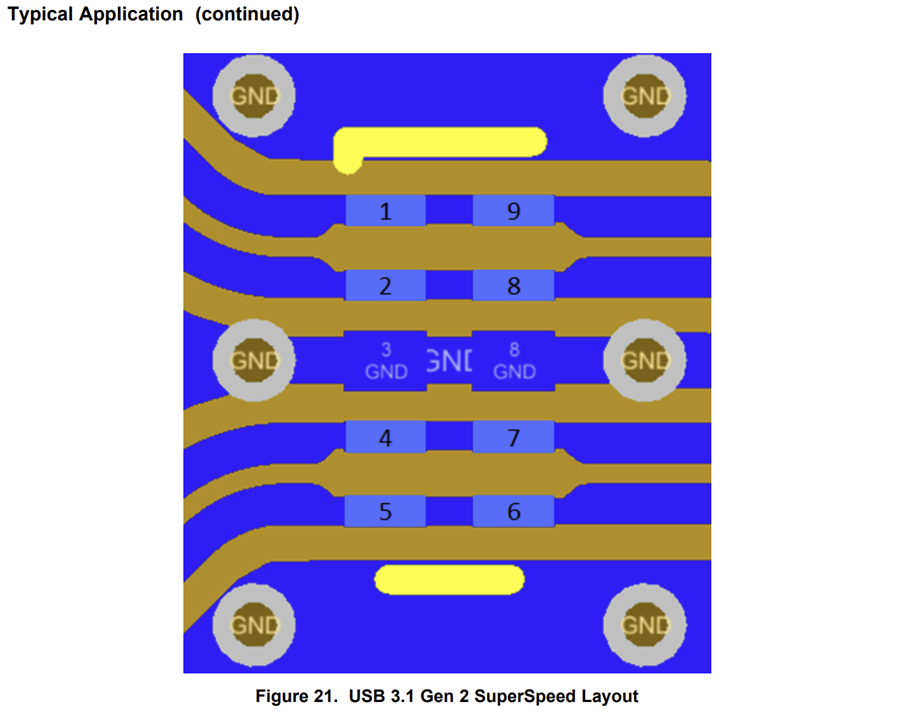

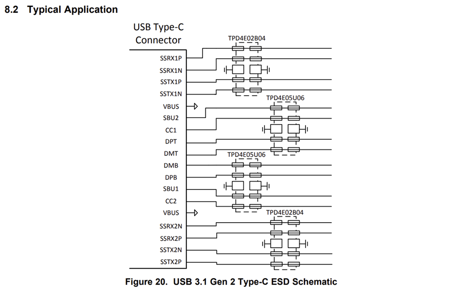

Hello experts
Is it correct to understand that 1-10, 2-9, 4-7, and 5-6 pins are connected?
I don't understand the text here, and I am confused.
It says:
Not connected; used for optional straight-through routing. Can be left floating or Grounded
I think 6-10 can be either floating or GND, but if that is the case, the signal does not penetrate
