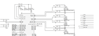

    What I want to ask is whether LMH1208 without an internal locker means it needs to add such a device to the external circuit?
    Can LMH1228 output SDI without adding any external components
    LMH1228 can drive SDI directly without additional external components as shown in the example below.
