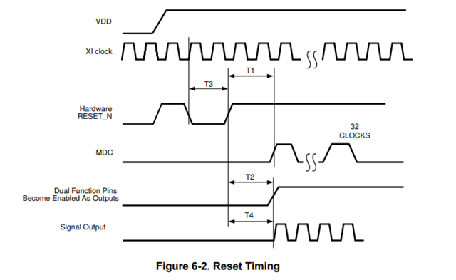

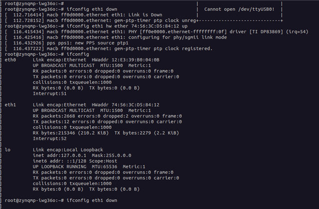

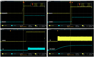

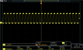

I am currently working on a custom board based on the Xilinx Zynq UltraScale+ MPSoC and using the Texas Instruments DP83869HMRGZT Ethernet PHY. We are encountering a critical issue where the PHY is not consistently detected during the boot process.
In some instances, the PHY is correctly detected by U-Boot, while in others, it fails to initialize. This intermittent behavior is impacting the reliability of our system and is a major concern for our project.
Could you please assist us in identifying the root cause and suggest possible solutions or debugging steps to ensure consistent PHY detection?
