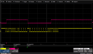

We see that the nFAULT pin toggles between 'low' (single wire error) and high (no single wire error) when CAN L is shorted to GND and chip is in NORMAL state. This behaviour is only present when there are longer sequences of recessive bits in the transmitted CANFD frame. Is there a known issue for the fault CANH shorted to GND?

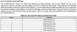

    In order for nFault to report properly, there are certain conditions that need to be met (this is detailed fully at the end of section 8.3.7.1.4 of the datasheet).

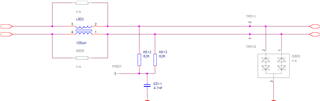

    On your schematic, I see you have effectively ~120 Ohm termination. During your test, what was connected to the CANH and CANL lines? Is there another 120 Ohm termination present somewhere on the line?
    The parameter spec R_CBF also defines that valid characteristic impedance that the CAN bus should have is 45 to 70 Ohms. In a properly terminated CAN bus, there should be two 120 Ohm resistors at opposite ends of the bus, which is an effective resistance of 60 Ohms.

  • Hi Ethan
    Thank you for claryfing the maximum data rate.
    Yes, 120R termination is used at the other end as well.

    As some further background for nFault, a simple way to think of it (but internally much more sophisticated) is that the device is adding up the currents on each of the dominant transitions. If it reaches a certain current threshold at a time greater than tCBF, then the error flag is raised. The reason your nFault pin is toggling is because the current threshold is just barely triggering and then resetting. Out of all the CAN bus fault conditions (CANH shorted to VSUP, CANL shorted to VCC, etc), CANL shorted to GND accumulates the smallest amount of current across these 6 tests.

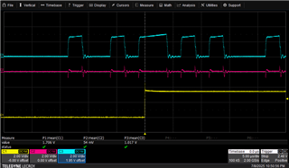

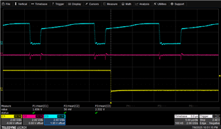

  • Hi Ethan,
    sorry for the delay.
    CANH/L measured at connector side, not CAN receiver side.
    Yellow: nFault
    Blue: CAN H
    red: CAN L (shorted to GND)
    Thank you
    BR
    Marcus

  • Marcus,
    Thank you for those precise waveforms.
    Is this behavior consistent across multiple TCAN1043A devices? Or this an outlier?
    From those waveforms, I can see that nFault is behaving properly for this device. It is triggering when CANH is high for longer periods of time (>2.5us). On the second waveform, we can see that CANH is high for 2.5us or less. Hence why after 4 dominant to recessive transitions causes the nFault pin to switch back to high in the second waveform.
    My recommendation is to either lower the data rate or to keep nFault as a purely informational pin. Even when CANL is shorted to ground, communication is still possible. The differential is still large enough that valid CAN bus frames can be read.
    Let me know if you have any other questions,
    Ethan

  • Hi Marcus,
    nFault will output low (indicating a fault) during a short if all datasheet conditions are met (which I have also described in my previous messages). Since your system alternates both inside and outside these conditions, the nFault pin will change between high and low. So the answer to your question is yes, TCAN1043A is operating as the datasheet states.
