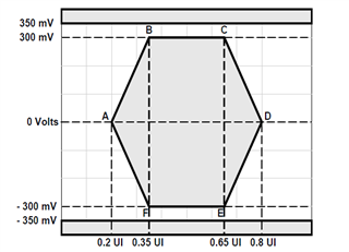

Would we have the eye diagram for the 011 and 012 at 20Mbps or guidance on what eye diagram limits we should expect in order to validate ? similar to below:

    However as far as guidance goes on the eye mask - they can derive it from the datasheets and I will quickly go over how to do that.
    The max and min levels (represented by the grayed out bars at the top and bottom of the given chart) should be abs max ratings - or since this differential the maximum output of the diff driver with a standard load (100 ohms) - that is going to be +/-450mV - so instead of +/-350mV like shown in reference it should be +/-450mV.
    The Y-Axis position of points B, C, F, and E should be based on receiver thresholds (basically anything lower than F or E will definitely give a logic 0 and anything higher than points B or C will give a logic 1).
    For the 012 that would put B and C Y-Axis position at 0V and F/E at -100mV. Anything at -100mV or lower is a logic low and anything that is 0V or higher is guaranteed to be a logic high.
    A/D should just be the halfway points between them - so -50mV would be a good place to put it.
    The X-axis positions would be the same on this guidance - we don't want transition times to take up more than 1/3 of the total interval - the x-axis distance from A to F and E to D is 0.15UI - and when you add both of them up that gives you roughly 1/3 of the time dedicated to transition time. Replace 1UI as 1/(10MHz) = 100ns (assuming double data rate - i.e. one cycle transmits 2 bits - if it is one cycle per one bit then it would be 50ns).
    The thresholds on the receiver device are not symmetric across zero so the eye mask doesn't need to be symmetrical either - however the eye opening most likely will be symmetrical because the driver has the same drive strength regardless if it driving high or low - the offset is so that the bus will read idle voltages as a logic high.
    This is a pretty quick/crude eye diagram mask - but it should capture all the needed elements to test SI with these devices.
    So in conclusion.
    Grayed out bars should be place >450mV and <-450mV as you shouldn't have differential voltages larger than that.
    A should be placed at [-50mV, 0.2UI]
    B should be placed at [0V, 0.35UI]
    C should be placed at [0V, 0.65UI]
    D should be placed at [-50mV, 0.8UI]
    E should be placed at [-100mV, 0.65UI]
    F should be placed at [-100mV, 0.35UI].
    If the eye opening passes that mask test - you should have good data integrity.
    Please let me know if you have any more questions!

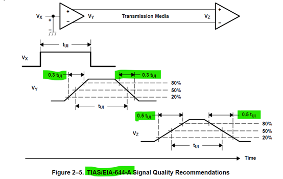

    I am following up on this thread as Olivier is OoO. Could you please share the acceptable limits of the following parameters:
    1) Rise & Fall times of LVDS at the transmitter end + Receiver end.
    For example:
    2) Bit error rate
    3) Pk-Pk jitter
    4) Mask hits (Violations at mask)
    5) If any...
    Please share any reference application note (TIA/EIA-644-A Standard) on signal quality.

  • Hi Geraldine,
    Sorry for the delay while E2E was down for maintenance.
    1. Figure 2-5 that you share are the LVDS recommended values.  So at driver end 0.3 * unit interval and 0.5 * unit interval at the receiver.
