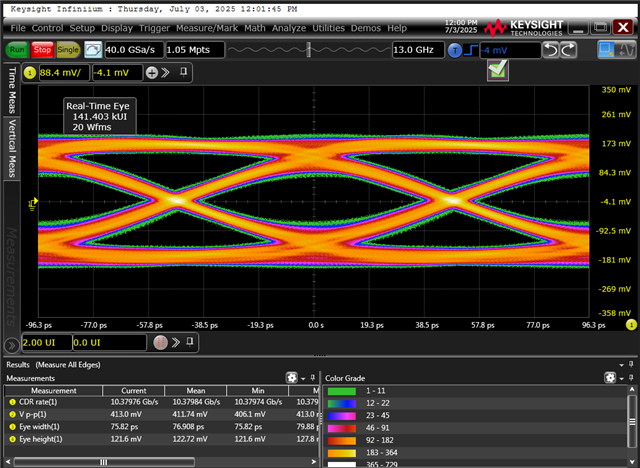

Hi team.

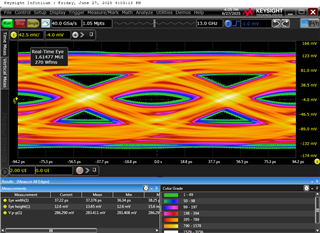

Could you help to check how can we pass the eye diagram?
Leo
  • Hi Leo,
    Is this the eye diagram at the SFP port?  Has the customer adjusted de-emphasis?
    Drew
  • 是SFP port,狀況是用Retimer  打PRBS9出來的訊號有問題,測試眼圖fail ,設定用一下表格去設定,但是眼圖有問題,請問這設定有問題嗎?還是需要再設定甚麼?
  • This is an SFP port. The issue is that when using a retimer to transmit a PRBS9 pattern, the resulting signal has problems — the eye diagram test fails. The configuration was applied using the table below, but the eye diagram still has issues. Could you please help confirm whether there is anything wrong with the current settings, or if there are additional configurations that need to be made?
  • Hi Kidd,
    Please configure de-emphasis and VOD to compensate for channel loss between DS110DF111 and the SFP port.
    What is your channel insertion loss between DS110DF111 and SFP port?  Are you measuring singled-ended signal or differential signal?  The VOD looks low for default 600mV setting.
    Drew

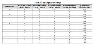

  • The test signal is differential. The test setup does not include any input signal — it is purely the PRBS9 signal generated by the Retimer.
    Please help confirm whether the following commands are correct:
    For setting de-emphasis to –3.3 dB:
    i2cset -y 12 0x18 0x15 0x54
    For setting VOD to 1300 mV:
    i2cset -y 12 0x1b 0x2d 0x87
  • Hi Kidd,
    Yes, these settings look correct.  A few additional notes:
    • It appears you are configuring two different retimer devices with the command you showed (different I2C addresses).
    • Please ensure you are selecting the desired channel register set based on value in 0xFF

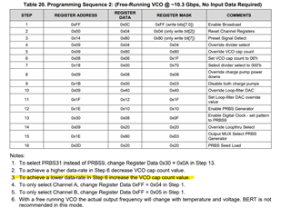

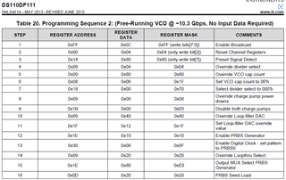

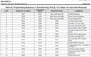

    We are using the DS110DF111 in Free-Running VCO mode, configured to output a PRBS9 pattern.
    The current measured data rate is 10.58 Gbps, but the expected rate is 10.3125 Gbps.
    Is there any further adjustment needed to correct the data rate or improve eye diagram performance?
  • Hi Kidd,
    Since you are using the free running VCO, some error from nominal 10.3125 Gbps data rate is expected.
    • As noted in the programming sequence in the data sheet, you can reduce the data rate by adjusting the VCO cap count value set in step 6.
    • De-emphasis and VOD are the primary settings to adjust on the transmitter side.  Are you meeting your target eye mask?
    Drew
  • hi:
    After issuing the command i2cset -y 12 0x18 0x08 0x07, I'm still unable to achieve 10.3125 Gbps.
    Is there any way to fine-tune it further?
    In addition, after adjusting the VOD to 1300 mVppd and setting the De-Emphasis to –3.5 dB, the eye height and Vp-p still appear insufficient.
    When I increased the De-Emphasis to –12.0 dB, the eye diagram degraded even further.
    Your assistance would be greatly appreciated. Thank you.
    0x08 =0x06 10.58 Gbps
    0x08 = 0x07 10.379 Gbps
    0x08 = 0x08 10.21 Gbps
  • Hi Kidd,

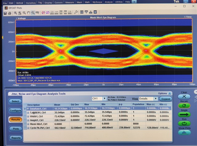

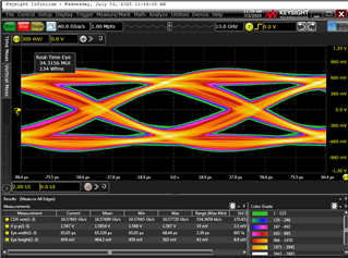

    Unfortunately, there is not a way to fine tune the VCO rate further.  The free-running VCO is not intended to provide precise data rate.  If you require a 10.3125 Gbps signal, you will need to have an input signal for the retimer.  Can you supply a 10.3125 Gbps data input to the retimer?
    A few questions:
    • What is the insertion loss between the DS110DF111 and the SFP port?
    • What specification are you trying to pass?  SFF-8418?
    • I'm a bit confused by your scope captures.  A previous scope capture showed ~1.5Vpp, but this capture shows ~413mVpp.  What is the difference between these captures?

    We're not sure why there is a discrepancy between the waveform measurements. The result showing around 1.5Vpp seems more accurate. Adjusting the VOD and De-Emphasis did not improve the signal.

  • Hi Kidd,
    The electrical standard for SFP+ is defined by SFF-8418.  I believe this is what you are testing for.
    Something seems unusual with your test setup.  The signal VOD should be correlated to your VOD setting and de-emphasis setting.

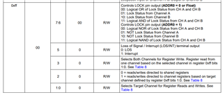

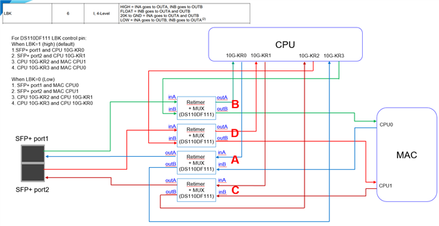

  • hi Drew Miller:
    I tried setting register 0x00 to 0x01, but I still cannot write to the De-Emphasis register (0x15).
    Here are the commands I used:
    # i2cset -y 12 0x18 0x00 0x01
    # i2cget -y 12 0x18 0x00
    0x01
    # i2cset -y 12 0x18 0x15 0x41
    # i2cget -y 12 0x18 0x15
    0x00
    Even after setting 0x00 to 0x01, register 0x15 still reads back as 0x00.
    Could you please help check why the value isn't being written successfully?
  • Hi Kidd,
    Are you selecting the channel register set using global register 0xFF?
    Drew
  • hi Drew Miller:
    1.I also observed that devices at I²C address 0x19 and 0x1B return 0xFF = 0x40, which appears to be an invalid or unexpected default. I plan to reset and explicitly configure these before use.
    Please let me know if there are any additional precautions I should be aware of when switching register sets.
    # i2cget -y 12 0x18 0xff → 0x00
    # i2cget -y 12 0x19 0xff → 0x40
    # i2cget -y 12 0x1a 0xff → 0x00
    # i2cget -y 12 0x1b 0xff → 0x40
    The current channel configuration is as follows:
    Channel A:
    i2cset -y 12 0x19 0xff 0x01
    i2cset -y 12 0x1b 0xff 0x01
    Channel B:
    i2cset -y 12 0x18 0xff 0x02
    i2cset -y 12 0x1a 0xff 0x02
    2.As shown in the diagram, the MAC is transmitting a 10 Gbps signal; however, the retimer does not appear to produce any output. Could this be due to a misconfiguration in the retimer settings, or are there other potential causes to consider? Additionally, if Channel A fails to detect a valid input signal, will Channel B still be able to achieve CDR lock independently?

  • Hi Kidd,
    Apologies for the delay, can get back to you with more details tomorrow.
    Regarding your diagram:
    • CDR lock on CHA and CHB are independent
    • Have you checked retimer registers to see if channel has CDR lock?
    • You diagram shows 10GBase-KR.  Have you disabled link training and auto-negotiation?

  • hi :
     Polished English Version
    Channel configuration based on the block diagram:
    1. Select the channel by writing 0xFF:
    CH A
    i2cset -y 12 0x19 0xFF 0x01
    i2cset -y 12 0x1B 0xFF 0x01
    CH B
    i2cset -y 12 0x18 0xFF 0x02
    i2cset -y 12 0x1A 0xFF 0x02
    Read 0x02. bit 3 = CDR Lock, bit 4 = Eye/Lock.
    Re‑validated that 0xFF is reset to 0x00 after each read.
    All channels currently read 0x00, indicating the CDR has not locked yet.
    The MAC is outputting a clean 10 Gbps signal, but the retimer still fails to achieve CDR lock.,
  • Hi Kidd,
    By default, this device will lock to 10.3125 Gbps data.  Acquiring CDR lock to a clean 10G signal is typically not a challenge.
    A few questions:
    • Are you performing any additional register configuration prior to checking CDR status?
      • You can try resetting channel register set by setting channel register 0x00[2] = 1b1.
    • Does the retimer show signal detect?
    Drew
