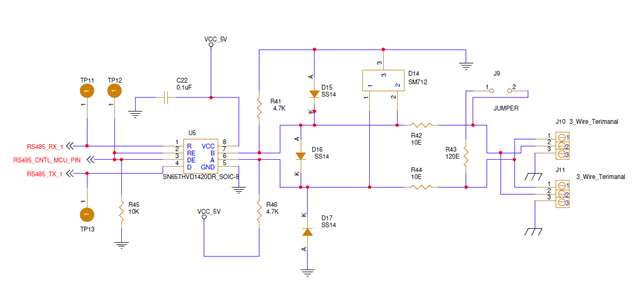

We have small issue with THVD1420 RS485 communications some times am getting garbage value on RS485 bus.could you please suggest me where is the mistake ?
and here am attaching my circuit and PCB desigh Please go through it Thank you.
This is my circuit
This is my PCB desigh file
  • The schematic and the PCB do not match.
    What is the purpose of D16? RS-485 signals are bidirectional.

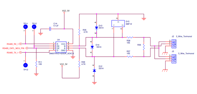

    Apologies for the confusion in my earlier communication — the schematic I had attached contained an incorrect part name. Please find the correct schematic attached with this message.
    The same design has been used successfully in my previous implementation, where it worked reliably with a setup consisting of one master and one slave.
    However, in the current application, I am using a single master and over 120 slave devices. Under this setup, I occasionally receive incorrect or invalid data.
    Kindly review the attached corrected schematic. I would also like to confirm the following:
    • In the earlier schematic, you mentioned the use of D16. In this updated version, can I safely remove D14
  • You must remove D14. You also must remove R36 on all nodes, except at the two ends of the bus. You also should remove R35 and R39 on most nodes.
  • Hi Sankar,
    Clemens is correct - D14 shouldn't be there - it will cause garbage data and only the 2 end nodes (start and end node) should be terminated with a 120 ohm resistor.
    Ideally the network topology is daisy chained to minimize unterminated stub lengths - for this device your unterminated stub length max (where length is measured as deviation from main trunk of bus) should be <= 350mm - this assumes that phase velocity of the transmission media you are using is ~78% of c - which is pretty typical in RS-485 systems.  Max unterminated bus length : L <= t_tr(differential-minimum time listed)/10 * Vp - where t_tr for this device has a smallest value of 15ns listed as its differential transition time and Vp is assumed to be 78% * c - so there could be some difference depending on the phase velocity of the medium you are using.
    Please let me know if you have any other questions and I will see what I can do!

    As for the PCB - it looks okay. Ideally you want the A/B output lines differentially coupled - but the A/B traces are really short on the PCB and this isn't that fast of a device so it shouldn't be causing that much issues - if you do a revision however I would at least try to make the traces the same width and as close as possible to the same length - as that is just best practice - but I really doubt that is causing the issues I do think the main issue originates from D14. when "B" goes high you will have trouble sending that signal due to the diode. The 712 diode you have should be enough w.r.t. protection needs.
