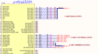

We are using the TL16C752DPFBR Dual UART, parallel interface with ATMEGA2560 MCU,
While we are executing the code to get the registers data on data lines from UART chip we are facing the issues on register values mismatch...we have verified the code properly
I'm attaching the UART & MCU schematic images for the verification of the functionality...
Also i'm attaching the observed serial data for UART register values below

    Can you verify the RESET pin is properly biased and isn't toggling once it powers up? I believe when this kind of error occurs it may be because of the reset pin.
    You may also want to probe XTAL1 to see if it's getting a good clock signal.
    -Bobby
  • hi,
    as per you suggestion i tested the RESET and CLK functionalities
    1. Before mentioning about RESET section, as per the attached schematic image just verify the RESET pin connection to GND, As per data sheet it is "active high logic pin"
    to do the normal operation of UART i tied RESET pin to GND through R136 (10k res). So i didn't found any toggling situation
    2. Proper lock signal at XTAL1- Pls find the attached sch image for crystal part and connection details
        Observed the Proper 18.432MHz clock signal at XTAL2 not on XTAL1, i didn't found any signal on XTAL1

    Can you put the RESET pin and the CSB pin on an o-scope and redo your testing to see if they ever toggle during the test? I'm wondering if you're the CSB or the RESET pin is changing state at any point during the write/read tests. (maybe due to noise)
    Can you also walk me through the initialization of the code and the write/read checks?

  • Hi
    We are able to communicate the IC, RESET the IC at initial power on with ms delay then it is working perfectly.. thanks for the support
    i'll get back to you if anything required
