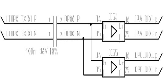

For an embedded project, I'm searching for a way to duplicate a display port channel 1:1.
I have a DP source which shall drive two identical monitors with the same DP signal (i.e. the second monitor will show exactly the same content and its AUX information will not be read).
I want to use two DP118 both connected to the same DP source. Do you think this has a chance to work?

    This is not something that has been tested in the lab.  Typically, DP sources are designed to be only support a single load and by having two DP118, it will appear as two loads.  You really need a splitter, unfortunately TI does not have a splitter at this time.
    I know that this is not the common way, but I think it could work. Its a pitty that the 50R termination resistors are integrated in the chip. With two DP sinks at one source I think the signal amplitude will be cut to half. But even so the DP118 should be able to amplifiy the signal again.
    Do you think the DP200 is the better solution? But the chip needs to be connected to the AUX channel and maybe its not possible to connect two chips to one AUX channel.
    Martin

  • The solution is running a few years now. But only with DVI as the DisplayPort host and monitor needs bidirectional communication via the AUX channel.
    DVI is simplier here with the monitors just displaying what they get.

  • No, we are using two SN75DP118. One placed on top, the other placed on bottom of the PCB to keep stubs short. Sadly the solution supports only DVI/HDMI as DisplayPort monitors needs bidirectional AUX channel communication with the host in order to work correctly.
    The idea to overcome this issure is to use a small FPGA to split the AUX channel. But we never implemented this.

  • Yes, we are connecting AUX/DDC to the first monitor and therefore all data comes from this display.
    The second (clone) monitor has no AUX/DCC connection and therefore just has to handle with the data it gets. I.e. the display must be compatible with the resolution that uses the first monitor. Our customer simply uses two identical displays.
    Fact is that with DisplayPort it is not so easy because the second monitor will not switch on without AUX channel communication. So leaving the AUX pins open results in a second monitor displaying just nothing...
    Ok, DDC SDA line is bidirectional but as there is only an EEPROM in the monitor that is read out by the DDC host, no electronic unit within the monitor "knows" that the DDC EEPROM was red out. It just starts displaying something when there is valid data on the DVI lines.
