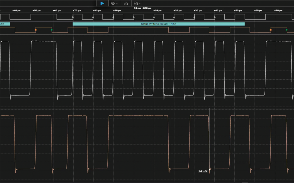

We've developed an HDMI 2.1 FPGA development board using the TDP1204 and TMDS1204 devices. On approximately half of the boards, the device does not respond to I2C communication.
Here are the configuration details:
  • MODE pin: Floating (I2C mode)
  • VCC: 3.3V
  • VIO: 1.8V
  • I2C lines (SCL/SDA): 1.5kΩ pull-up resistors to VCC
  • EN pin: 1kΩ pull-up to VIO and a 100nF decoupling capacitor
We've tried accessing all supported I2C addresses (0x5B, 0x5C, 0x5D, 0x5E), but the device doesn't acknowledge any of them.
I’ve attached a scope capture of the I2C communication. The I2C interface runs at 100 kHz.
Additional observations:
  • The HPD_OUT pin is high.
  • When I force the EN pin low, HPD_OUT goes low.
  • Releasing EN (allowing it to be pulled high to VIO) causes HPD_OUT to go high again.
Does anyone know why the device might not be responding to I2C?
Any insight or suggestions would be greatly appreciated.
Thanks!
Marco

  • Hello J,
    Thanks for your feedback. I haven't connected the I2C to VIO yet. At this moment that's not an easy task.
    However the TDP1206 datasheet section 6.5 - Electrical Characteristics mentions a high level voltage input (Vin_1p8v) for SCL / SDA from 1.19V till 3.6V for test condition VIO = 1.7V and VCC = 3.6V.  This would suggest that this configuration is supported.
    Marco

  • Hello J,
    I’ve rewired the I2C lines to use VIO (1.8V), but unfortunately, this didn’t resolve the issue. The device still doesn’t respond to any I2C addresses.
    I also measured the power supply ramp-up sequence and the EN pin. Everything appears to be compliant with the Power-On Timing Requirements (Figure 7.1).
    The HDMI device is mounted on an FMC card. I tested the same (failing) FMC card on a different FMC carrier board, and in that setup, the HDMI device does respond to I2C.
    While comparing the power-on timing between the two carrier boards, I observed that:
    • On the working board, Vcc ramps up faster than VIO.
    • On the failing board, VIO ramps up earlier than Vcc.
    I've attached the scope captures showing the power-on sequence.
    Could the earlier rise of Vio lead to latch-up or undefined behavior? The datasheet doesn't mention any power sequence recommendation.
    I don’t have control over the individual power supply ramp sequences.
    Marco
